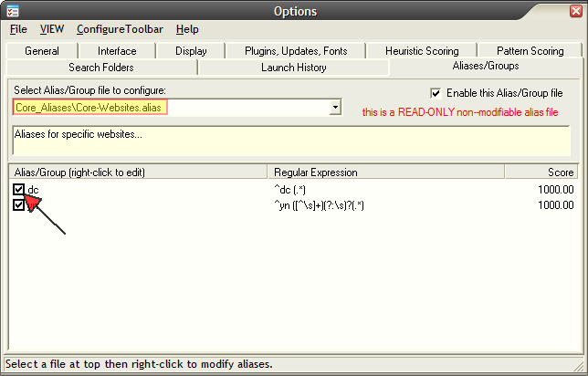

Notice that 'DC U' doesn't. But that isn't supposed to work, since 'DC ' (notice the space) triggers the DC search alias, and anything you write after that space will be used in the query to be made to the forum.
Maybe you could try disabling that alias, to see if you get the same results.
(instructions: see attached image, just deselect that box)
Screenshot-07_07_11,23_09_51.pngapparent issue with aliases, notably "DC search"
