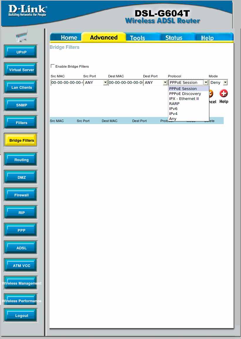

It turns out D-Link has a router running on that very same architecture (the DSL-G604T) and unlike Actiontec, D-link provides a recovery utility to replace the firmware through the ftp interface, using ONE image file.
I ran the utility and it uploaded D-Link firmware to my actiontec modem, I figured, maybe the web-interface will work, if I'm lucky, and I can use that to upload the original Actiontec firmware, or just replace the d-link image with the actiontec one in the recovery utility.
It turned out I didn't even have to, because, appearantly, the D-Link software is running with no problems on my Actiontec router, eventhough it has completely different hardware. I can now get back on-line, use NAT and port forwarding, even wireless works. All features in the web-interface work etc,...
This D-Link software seems to have more features(see screenshot) in it's web-interface than I've ever seen in a modem/router; so why would I replace the original buggy and featureless actiontec firmware if the D-link firmware works just as well?
It turns out I was rather lucky the D-Link firmware even boots, since the device it was written for has at least twice as much memory as my Actiontec piece of junk.
The memory constraint had me worried, so I did a small stress test by calling on my VoIP while downloading stuff (probably not the best test one could do, it's not like p2p) and it worked fine. But at least now if I ever encounter problems I can revert back to the original firmware. (Though I'd like to avoid it if possible)
The original Actiontec firmware hasn't been maintained or updated since 2005 and it is full of bugs. One of the most annoying bugs is that it wants to log every dns-request without ever deleting/cycling the cache. When the memory is full, the firmware craches. Using any p2p app for 5 mins will do that. There is a temporary fix (by telnetting to the modem and disabling the caching), but it gets lost after reboot. So that's why I'd rather keep the D-Link firmware if I don't have any problems with it (so far so good)
