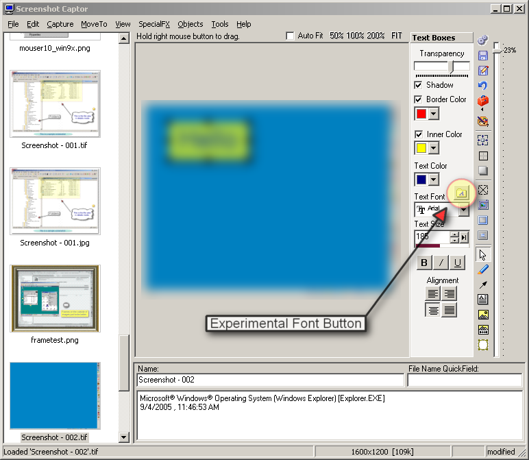

i put up a little test, can you try it here:
https://www.donation...nshotCaptorFTest.exe
it can be installed on top of existing installation.
the only thing i added is a new little font "button" on the text; try that and see if it shows chinese fonts in it.
if so, see if you can select them and type with them in text boxes.

Hi,
I've downloaded and installed it. The Chinese fonts can be seen and selected, but the contents of Text objects still formed in Arial font. Maybe the font in Yellow-area didn't be changed into what i choosed?
What i typed in the Yellow area is the same as red-circle one's.

« Reply #4 on: September 07, 2005, 07:28 AM »
ok, that's too bad, i was hoping it would be as simple as adding a unicode aware font dialog.
i'll try to look into another way to solve it and report back.
thanks for testing.
