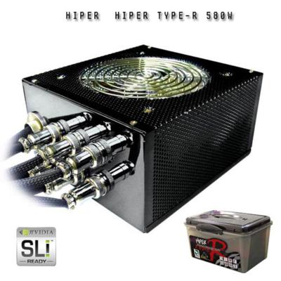

Trouble is that decent PSUs are expensive. If you do buy one get one that is future proofed. I an guessing your system has a 20 pin mobo connector - there are lots of decent PSUs with a 20 pin connector and an extra 4 pin block which clips to the end to make it compatible with the newer 24 pin connectors.
A PSU I have been seriously impressed with is Hiper HPU-4K580-MK Type R 580W Modular ATX2.2 PSU
It is beautifully built, completely modular, supports 20/24 pin mobos and comes beautifully packages in a reusable tool box! I bought it for a spare computer (long story) because it was well rated and a decent price.
-Carol Haynes (April 22, 2007, 04:10 AM)
AHA! So you're into fancy PSUs, don't ya? ;D
