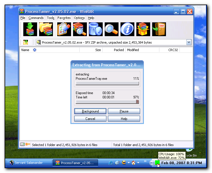

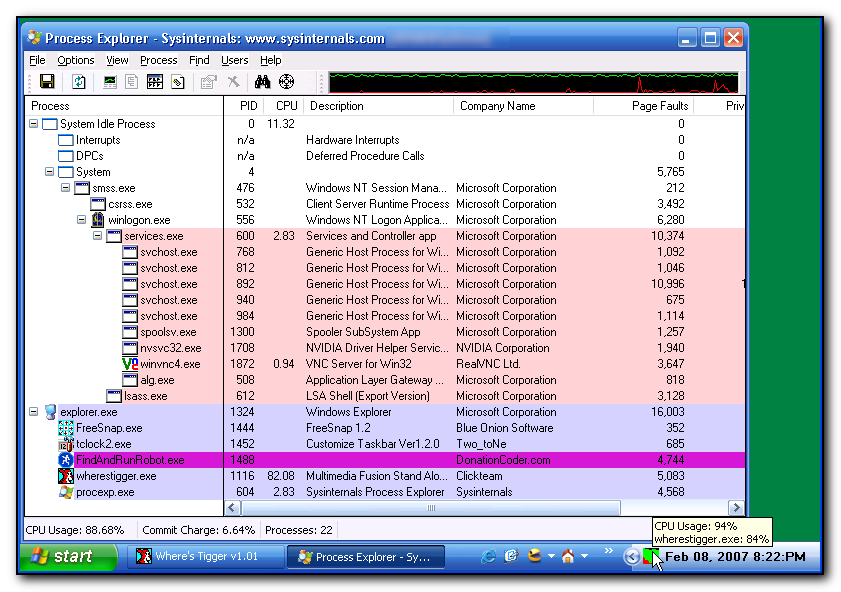

i have a problem with this PC where upon launching of a program, the CPU Usage shoots up to 100% eventhough it's not a resource demanding program.. it's a newly installed WinXP SP2 with no internet connection. other specs: Pentium 3 400MHz, 640MB RAM, Geforce4 MX440, etc..
i've tried scanning for spyware & viruses (eventhough the OS is newly installed), defragmented the hard-drive, tried changing the drivers for the graphic card. now, i'm thinking of hooking it up to the internet & run the windows update but before that, i thought i'd make a post here.. so does anyone knows why this happens? also attached some screenshots to explain this crazy thing..
Pc-crawl_ver001.pngCPU Usage shoots up to 100% !?!
Pc-crawl_ver002.pngCPU Usage shoots up to 100% !?!

well clearly in your screenshot its not a mystery, wherestigger.exe is using all your cpu.
Re: CPU Usage shoots up to 100% !?!
« Reply #4 on: February 09, 2007, 12:33 AM »
that's what i'm trying to find out, why is it using all my cpu? not only that program, any program that is launched, as can be seen in the 2nd screenshot..

Well, WinRAR does use up some CPU cycles, especially while compressing. Decompression is fairly fast, but then again - your box is more than fairly slow. Also, "wherestigger" sounds like a game, and most games will appear to use 100% CPU because of the way game messageloops are  coded.

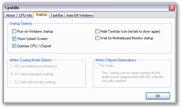

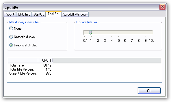

after googling for several hours and i found out that i seem to have a very bad combination of processor & motherboard that has no viable solution.. >:(
however in one of the threads, i noticed that there was a mention of CpuIdle to "cool" the system. i've heard of these type of software before, such as Rain, CpuCool and WinHLT but didn't think much of them. but among others, CpuIdle claims to "enhance stability" and i was desperate enough to try it out..
and after several days of usage, i am happy to report that CpuIdle manages to tame the high cpu activity and make the system usable. the spikes in cpu usage does occur, though not as frequently as before.. and since my other alternative is to get a new motherboard, this is much welcomed.. :)
for the record, CpuIdle is a time-limited shareware. Users can try CpuIdle for 30 days and after that are required to register. It costs USD30 or €30, depending on where you live.
finally some screenshots..
Config Screen - 1
Config Screen - 2
http://www.cpuidle.de/
P.S. a small disclaimer: benefits of software in this category are highly subjective and only in case of a unique situation like mine that it's usage is likely to be required. :)
