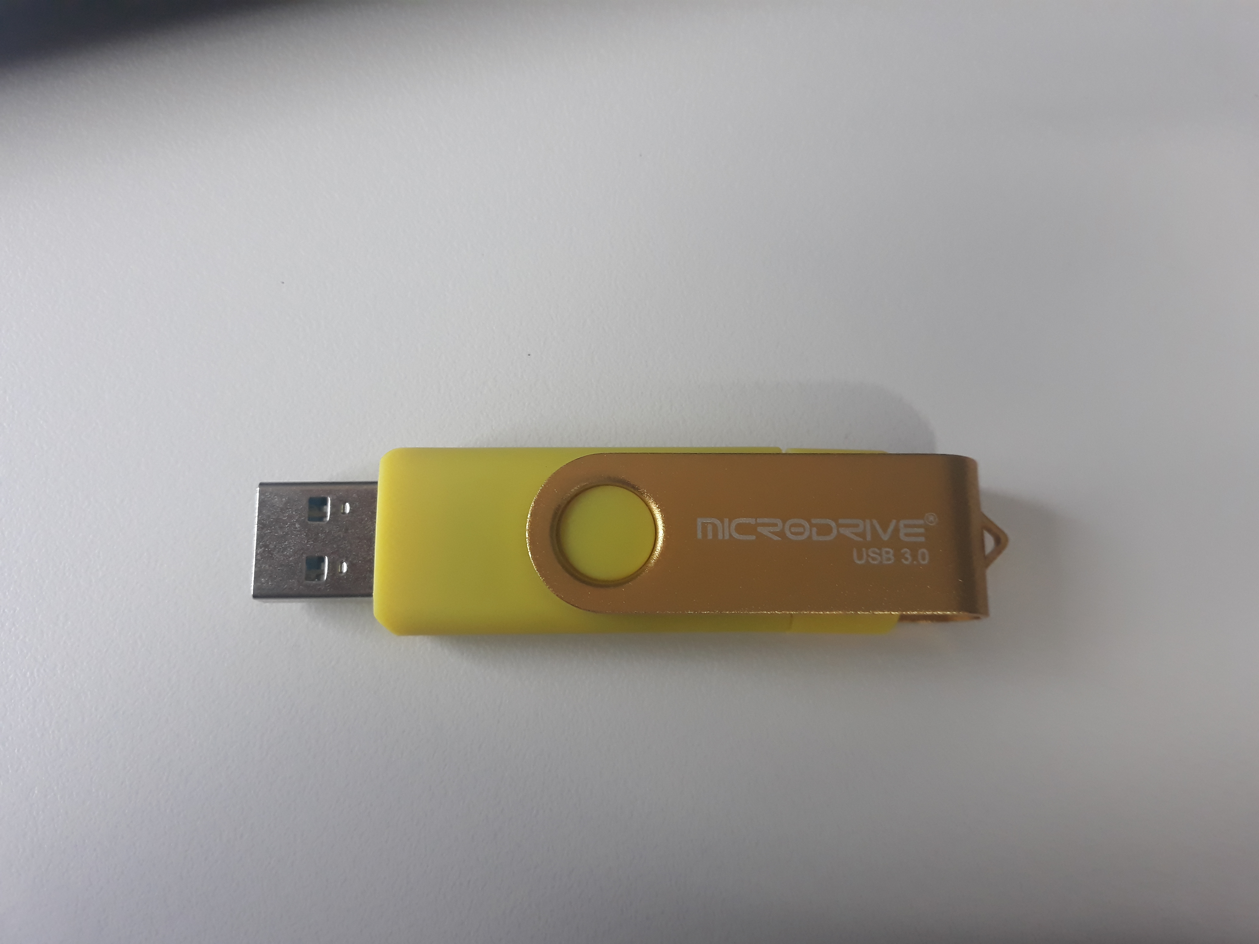

I have just received this pendrive :
AsusPortatil - 15_02_2019 , 9_35_33.pngReview Pendrive Microdrive usb 3.0 128 GB
The device is recognised in my laptop without problems. Only 116 GB are detected.
The device don't come with he capacity written in the product . See the photo.
20190215_093815.jpgReview Pendrive Microdrive usb 3.0 128 GB
