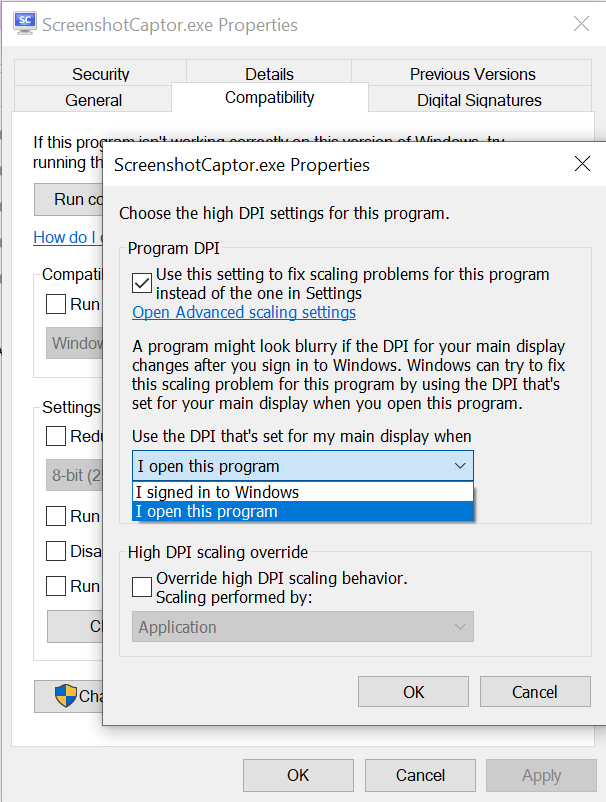

jcassella
I had the same shift+print screen problem this week with my new laptop.  High DPI laptop with a lower resolution monitor, the capture window was getting magnified.  I was able to fix it by going to the ScreenCaptor.exe file and right-click to set Compatibility -> Change High DPI settings -> High DPI scaling override -> Application.
danipg
  • Posts: 3
After many years using Screenshot captor on windows XP and windows7 without problems.
Unfortunately I am forced to use windows10, and I have the same problem with  a laptop connected to a external display.
It seems working fine after configuring sc  .exe properties as in attached screenshot.

Windows 10
« Last Edit: June 03, 2019, 10:10 AM by danipg, Reason: added solution »
ceebu
  • Posts: 12
i was having the same problem and after making this change, my problem is resolved
