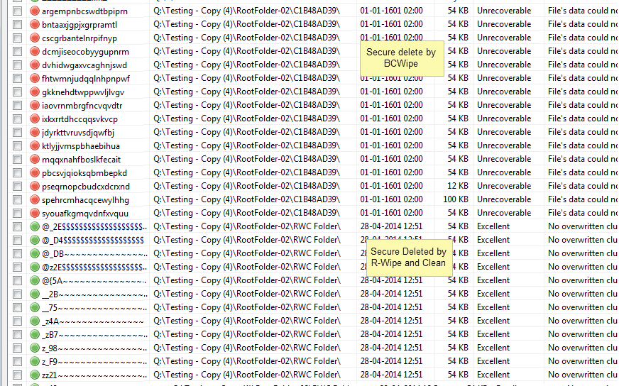

Below examples:
deleted testfiles from a 'test'-folder using BCWipe
(settings: wipe: MFT Records, Directory Slacks and NTFS Transactions Log File)
all 1 pass
deleted some other testfolder from a folder named 'RWC Folder'
(settings: wipe Alternate Data Streams and wipe cluster tips)
all 1 pass

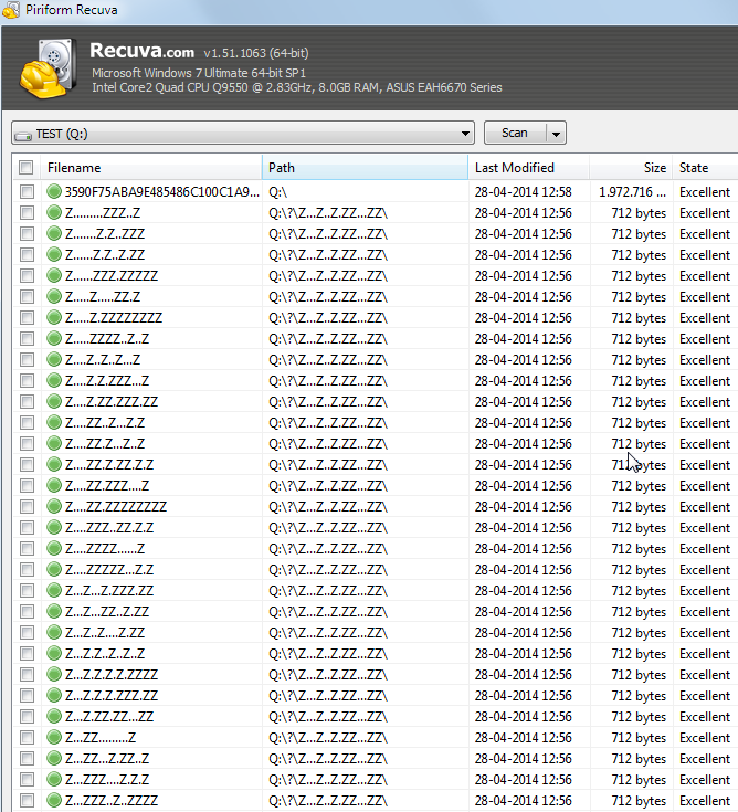

Examples of BCWipe and R-Wipe and Clean-28042014 125439.pngIDEA: Add CCleaner secure file delete to Explore/Opus context menu
Then run CCleaner settings:
1 pass,  wipe alternate data streams, wipe cluster tips, wipe MFT Free Space
CCLeaner-After Drive Wipe Free Space-28042014 125920.pngIDEA: Add CCleaner secure file delete to Explore/Opus context menu
You see, now, folders are filled with 'ZZZ'

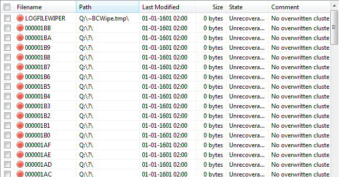

BCWipe, Wipe Free Space of a drive shows something like just Q:\?\
Like this
BCWipe Wipe Free Space-28042014 090347.pngIDEA: Add CCleaner secure file delete to Explore/Opus context menu
