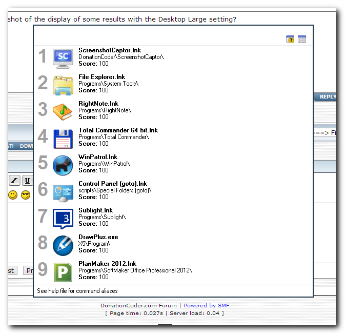

Could I have a screenshot of the display of some results with the Desktop Large setting?
TucknDar
  • Posts: 1,133
Re: Setting "Large Icon Slides" won't display icons
« Reply #4 on: February 17, 2013, 05:59 AM »
Screenshot - 17.02.2013 , 12_53_18.pngSetting "Large Icon Slides" won't display icons
edit: I've noticed that FARR displays the same sized icons with Desktop Large and Ridiculous set.
