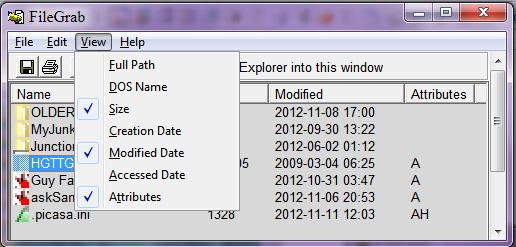

However, sometimes I want to capture more metadata about selected filename(s), and play about with it. For this I Copy the selected file(s)/folder(s) and Paste into a utility called Filegrab, which acts a bit like a bucket for file/folder metadata. After adding and deleting metadata for files/folders, this can give an editable and sortable display something like this:
The displayed columns in the view can be changed, like this:
When you have the display as you would like it, you just click, select and copy those lines of the display you want to communicate.

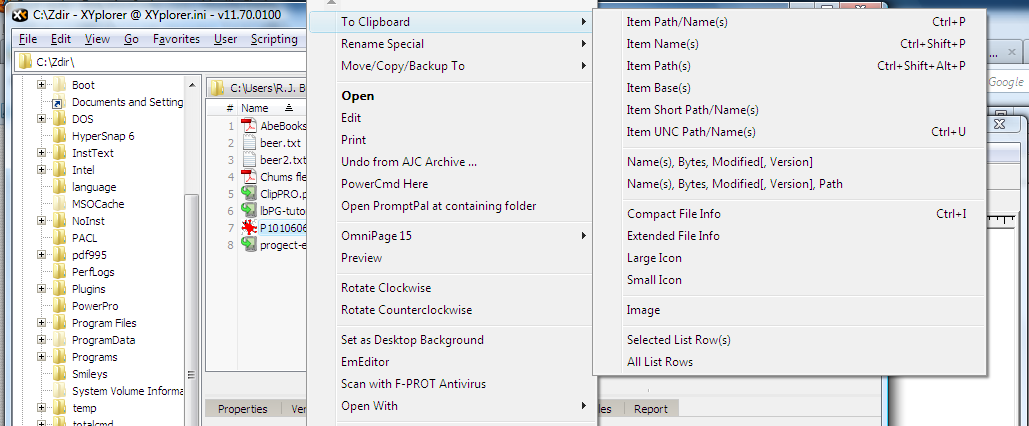

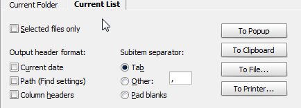

  • Posts: 3,199

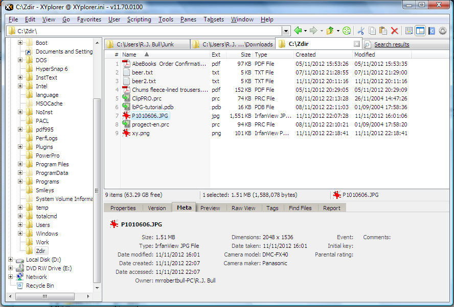

I don't know if it helps, but XYplorer offers extended metadata as standard.  The screenshots show the metadata tab on the main pane, and the send to clipboard popup from right-clicking on a file.  Choosing extended data puts something like the following on the clipboard (XY's Help says this data changes according to the file type):
DOS name: P1010606.JPG
Type: IrfanView JPG File
Location: C:\Zdir\
Size: 1.51 MB (1,588,078 bytes)
Space used: 1.52 MB (1,589,248 bytes), 388 clusters
Created: 11/11/2012 22:07:28
Modified: 11/11/2012 16:01:06
Accessed: 11/11/2012 22:07:28
Attributes: Archive
Metadata tab:
xy1.pngDONE: "Filegrab"-like functionality integrated into the file explorer.
Clipboard popup:
xy2.pngDONE: "Filegrab"-like functionality integrated into the file explorer.

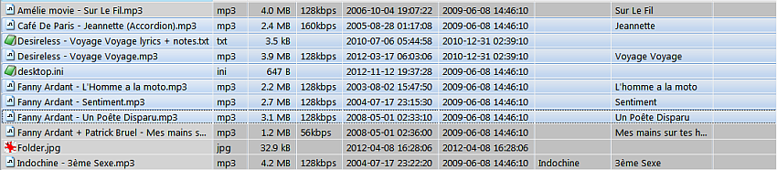

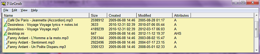

1. Select  files in Explorer (xplorer²) and Copy:

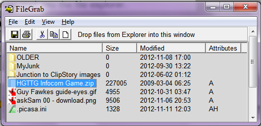

2. Paste what's in the clipboard (n file metadata records) into Filegrab's workspace, and tick ON for all the columns in view that Filegrab can offer:

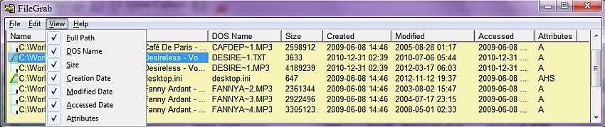

3. Untick those columns I don't want:

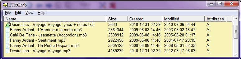

4. Delete the metadata for desktop.ini ( I don't want that) and Sort the metadata records on file size in ascending order (I could also add more files to the Filegrab workspace at this point if I wanted):

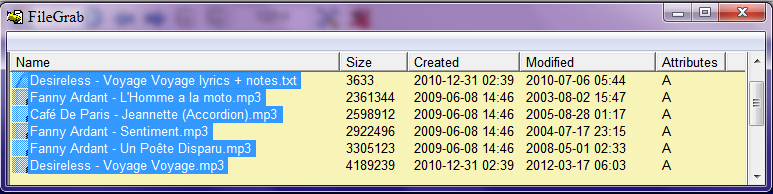

5. Select and Copy all the files listed in Filegrab (I could select fewer if I wanted):

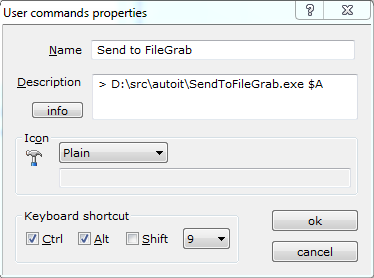

Here's a first attempt.
Put the SendToFileGrab.exe 'somewhere reasonable', then in xplorer2 go to "Customize->User Commands->Add new...". Choose whatever name you want, an optional hotkey, and for the "Description" field (which should really have been called "Command" O_o), add something along the lines of ">D:\src\autoit\SendToFileGrab.exe $A" (yep, the larger-than character is required).
The script currently requires FileGrab to be started - starting it if not already running is something to be added if the script otherwise works for you :)
  • Posts: 7,540
@f0dder: Many thanks! That works a treat!    :Thmbsup:

FileGrab.exe
[Content]
Windows cannot find 'FileGrab.exe'. Make sure you typed the name correctly, and then try again.
[OK]
___________________________
If you press OK, then you get the error message:
Ewwor
FileGrab not running, and ShellExecute failed
OK
If you press OK, then you are returned to the active window.
    • f0dder's place
Re: DONE: "Filegrab"-like functionality integrated into the file explorer.
« Reply #19 on: November 14, 2012, 05:59 AM »
Hm,
I think I have an idea what this could be. If you use Sysinternals' Process Explorer and check the properties of the SendToFileGrab.exe process (when it throws up the error messagebox), what does it's "current directory" say? My guess is that it's going to be the active directory in xplorer2 rather than the script directory, which means it won't be able to read the .ini file.
If that's the case, try moving it to your c:\windows folder and see if that solves the problem temporarily - I'll look into a better solution later, which obviously means reading the .ini file from the same directory as the .exe is in :)
  • Posts: 7,540
« Reply #20 on: November 14, 2012, 08:18 AM »
OK, when it fails to find FileGrab.exe, the process properties for SendToFileGrab.exe say that it is currently in the directory XYZ that has been selected to send some files from.
Putting the file SendToFileGrab.ini into the XYZ directory causes the SendTo to work fine.
However, putting the file SendToFileGrab.ini into the C:\Windows directory seems to have no effect.
Odd.
    • f0dder's place
« Reply #21 on: November 14, 2012, 04:41 PM »
There, .ini file path should be taken care of - embarrassingly simple fix :)
  • Posts: 7,540
« Reply #22 on: November 16, 2012, 03:44 AM »
Problem solved!
Many thanks @f0dder! That seems to work perfectly now.
By the way, in the discussion above, there are some notes about what file metadata you can get from which file explorer.
Just by coincidence, I have today tried out a proggie called SysExporter, and it was so good that I thought it might be useful if I wrote a review report about it. Here it is: SysExporter - (Screen-scraping) Export data from Windows controls - Mini-Review
What it shows is that, in the case of file metadata, you can capture all the metadata text that you can cause to be listed in a file explorer display window. For example:
...The next image shows the same approach, where I captured the data displayed by SysExporter about some music files listed in one of my file manager (xplorer²) windows. Rather nice. (Again, the embedded question marks - this time in the bitrate field). Notice how the column headings have also been captured in Excel.
