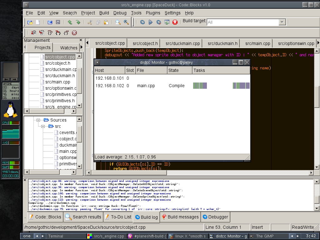

I actually got around to compiling code::blocks on linux, seems to be stable enough sofar (unlike what i've read in reviews of the linux version on past versions), though time will tell. - but- here's the twist:
It was -very- easy to make code::blocks use distcc!
Just replace all the g++ / gcc with distcc in Settings->Compiler.
Everything still works normally, you still get all warnings in the log etc, just get a majour speed boost :)
Here's a screenshot of my 3ghz box doing the work for my slow 1ghz Dell disaster computer.
