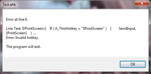

@skwire: Thanks for providing the script. I am totally new at this (AutoHotkey and stuff). I tried to run the script and got the attached error.
  • Posts: 5,286
Re: Taking Screenshot (via PrtScn) & MS Paint
« Reply #6 on: December 27, 2011, 11:52 PM »
Do you have the entire code on one line or something?
Nzyme
  • Posts: 100
« Reply #7 on: December 29, 2011, 09:15 AM »
It spans a few lines - 3 to 4 lines I think. (I have copied the code after clicking on "copy or print" link in the code box above and pasted it in Notepad) and then ran the script. Do I have it on the Notepad "just as" it appears in the code box above without the line numbers?
  • Posts: 5,286
« Reply #8 on: December 29, 2011, 09:18 AM »
It needs to be in Notepad just like you see it in the above code box (19 lines).
