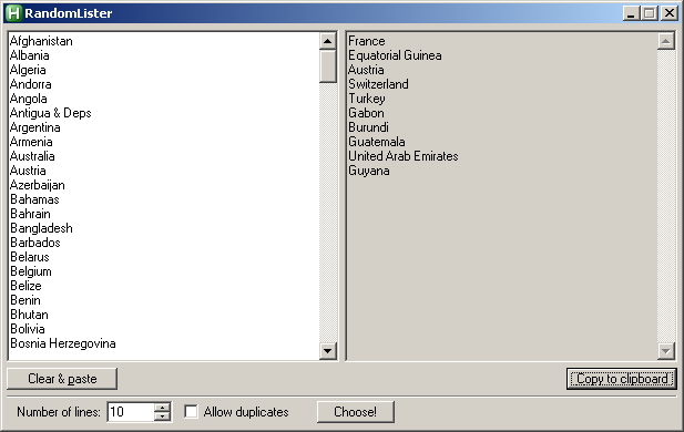

Give this a shot:  RandomLister
I wasn't sure if you wanted the results numbered sequentially or their actual line numbers from the source.
2011-12-18_122417.pngIDEA: Randomly select 'n' Lines from text list

« Reply #7 on: December 18, 2011, 03:53 PM »
The original concept was the results numbered sequentially, but as they appear on screen in order they are selected, its not necessary.
This meets the design requirement very well, many thanks.
You're welcome.  That was more of a proof-of-concept i.e. it's not resizable and doesn't save any settings.  Did you want these bits added?

Although resizing might be good for very large lists
Please download download RandomLister again.  The app should be resizable now.
