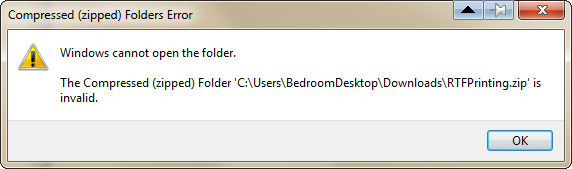

Hmm, I tried hollowlife's renaming, downloaded the file, but wasn't able to open it:

Also unable to open it with 7-zip.  :huh:
in the URL
-hollowlife1987 (December 13, 2011, 07:14 AM)
These last 3 words are crucial in the description of getting it to work...

Wraith, the link on your Blog is dodgy, it points to the zipfile with all lowercase letters, as hollowlife pointed out. Clicking the link gives me a 404 error-page.
If I right-click and select download, I (slowly) get a file of about 20 kB, but I can't open it. When copying the link text and changing the name into the correct case (using a new tab in my browser), it downloads fine and can be opened as expected.
The direct link in your #8 reply here works fine now, as does the attached download.
