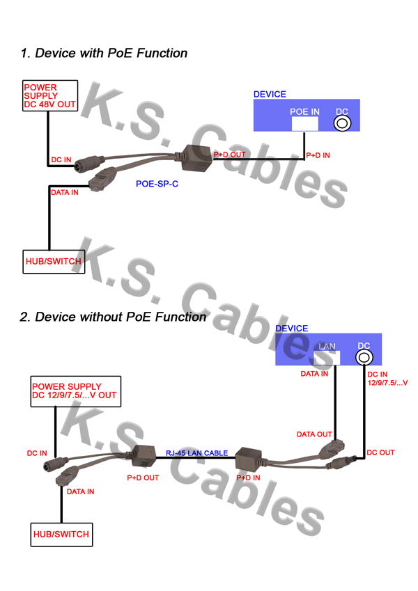

The device has to either be made to utilise PoE or you can use a breakout box to separate the power feed from the Ethernet cable before connection to the device.
Here's an example on ebay along with a connection diagram: PoE Passive Injector/Extractor
poe example2.gifPOE: Power over Ethernet confusion

Thanks, 4wd.  I was thinking I would need something on the device end but didn't know what.  When I googled it, I came up empty.  But didn't know what I would need is called a POE extractor.   :-[
