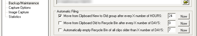

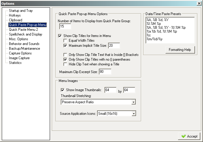

using the latest beta, on XP SP3:
My quick paste list "empties" regularly, seems like every couple of hours the list starts again from scratch (with no restarts, no sleep, etc of PC)
Settings are
other related settings:
