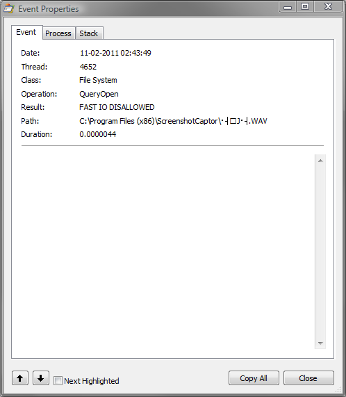

This fixed it for me http://channel9.msdn...56901-Stop-the-Ding/
I checked in Process Monitor and ccselect is called, then half the hd including a usb stick! is searched for that file. Seems like 30-40 random folders. Ends up in Windows folders with a successful DING.WAV ,stupid.
Notice file name of wanted wav file, weird.

Look at the file name. Is that normal?
Turning "Select" off in control panel for sounds make SC, or Vista, use Ding.wav - after search of that weird file name. Using the reg-file make it go silent. CCselect is referenced but nothing happens because it is set to nothing. Going back in to control panel, selecting any random file for select will work BUT when choosing nothing SC once again reverts to Ding.wav - must run reg file again.

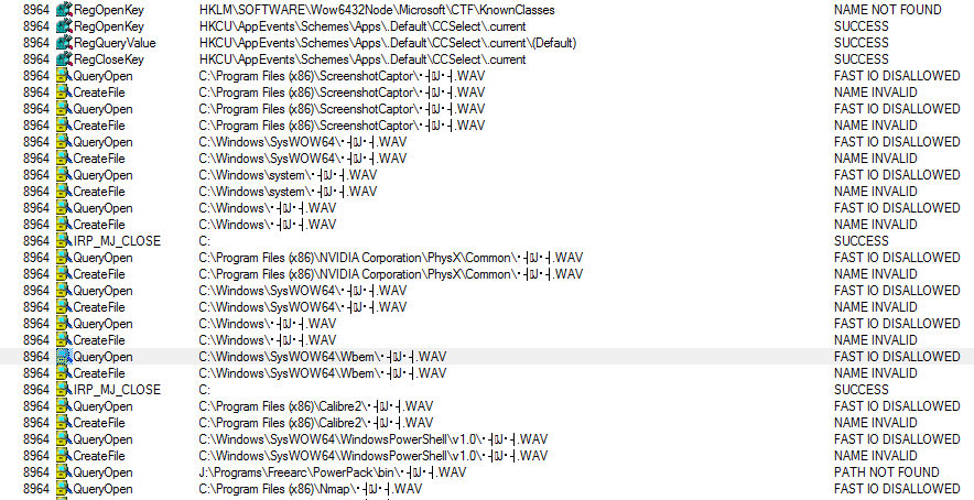

Here is a snippet from Process Monitor. Action from the moment I click.
I did not read comments but went straight to regedit  :P

Screenshot Captor is or at least it request that file. PID 8964 is SC. After I run that regfile crazy file name is not there. If I go in to sound panel and mess with Select entry, disable/enable 10 times - ending with not attaching any wav problem returns and reg-file must be run again.
For the rest of your questions I am ??? But I rarely touch sound panel, have no programs messing with it either. So weird. I would like to see other victims run Process Monitor when clicking.
« Last Edit: February 10, 2011, 08:30 PM by Bamse »

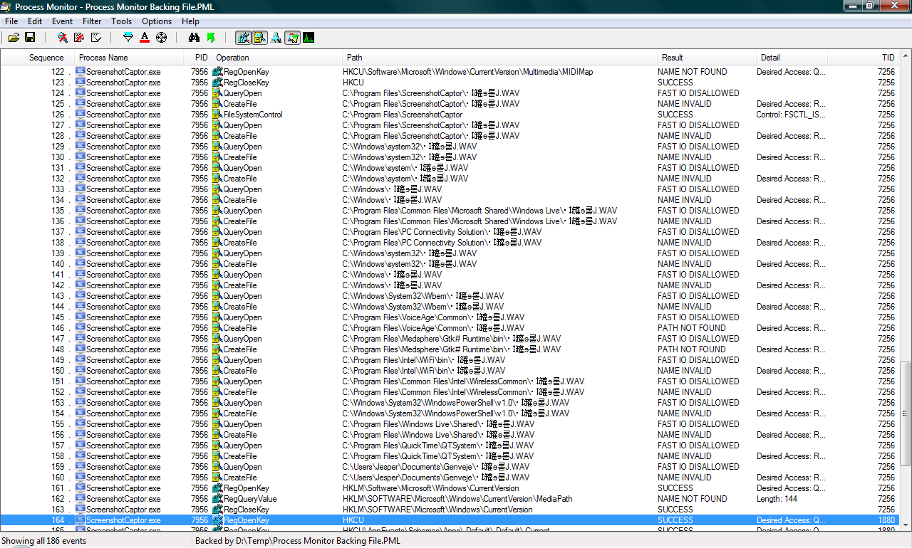

« Reply #16 on: February 10, 2011, 08:40 PM »
Bamse
  • Posts: 410
Re: Windows standard beep ("ding") when changing between screenshots
« Reply #17 on: February 10, 2011, 08:41 PM »
Also same here. When I first ran in to the problem I tried all sorts of changes, for mouse/keyb, changes in ease of access center, even folder settings. Nothing helped. I was about to say I have 102 processes running right now so don't mind a strange filename but remembered I have done no-nonsense/only SC running basic troubleshooting before.
Could it be a language/regional issue? I also tried changing keyb. to other lingo I think. I just noticed that Jesper Hertel seem to be Danish so we have language settings in common.
Thank God and Jesper for that pic  :D
