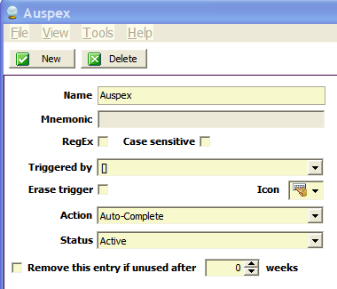

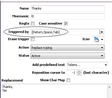

Do you have triggers set up? It's entirely possible to blank out the triggers altogether so that Auspex does not perform the replacement.
What I'm saying is this - do you have anything in the "Triggered by" field:
trig.jpgBuild 89
Nest question would be: is this occurring in any application? e.g. boring old Notepad - everything should work with that!
EDIT: are you just using "TAB" by any chance? Just found a bug.
joiwind
  • Posts: 486
  • carpe momentum
Re: Build 89
« Reply #9 on: January 24, 2011, 12:56 PM »
Yes, you're right - it's TAB. I have some triggered by just TAB and some with TAB and SPACE (I'm still testing after all...).
So SPACE works fine but it seems that ENTER won't work either.
