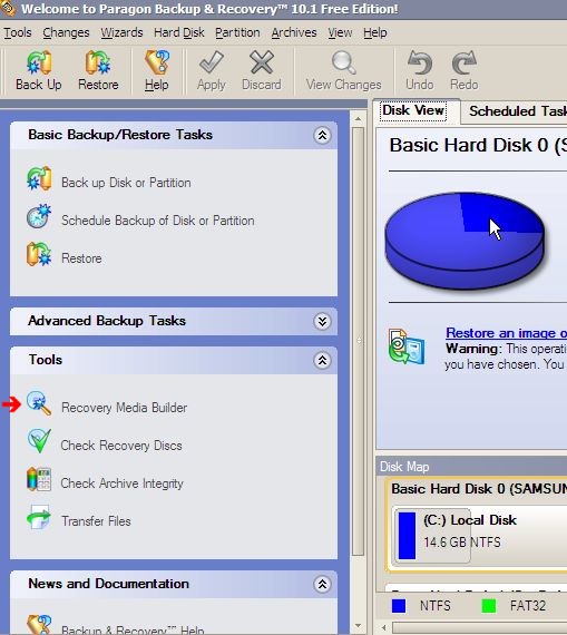

I'm a bit unclear on the "make a boot cd" step. How do I do that? I take it the CD does not hold the image, but a program to restore the image from the external drive?
Both Paragon Backup & Recovery and Macrium Reflect, (including free editions), allow you to create a bootable CD, (and/or Flash drive in the case of Paragon), that you can boot your system off so as to restore a previous backup from, for example, an external USB drive, CD/DVD discs or another internal partition/drive.
snap.jpgAfter re-installing XP - what?
eg. For Paragon Backup & Recovery Free Edition just click on Recovery Media Builder and follow the prompts, you'll have your choice of writing to an ISO, (to burn to CD later), writing a CD immediately or installing it to a Flash drive.
Addendum: FWIW, I'd do the following, (this is using Paragon B&R), if you have a Flash drive of around 8GB it should be more than ample for your OS with quite a few applications installed, (unless they are really big spacehogs):
1) Install PB&R Free Edition
2) Create Recovery Media on the Flash Drive
3) Create a system backup using maximum compression
4) Copy the backup to the Flash drive
5) Put it somewhere safe you can find it when necessary, (whenever I put something "somewhere safe" I can never find it again  :-\ )
This is what I've done with my netbook, I can get 2 complete OS backups on a 4GB Flash drive.
