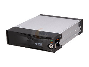

I would get one of these for my OS drive:
1. Remove current XP drive and set it aside
2. Add new drive for Win7
3. Install Win7
4. Swap out Win7 drive for the XP drive when you want to go back
Not as convenient as dual booting, but it would be a whole lot easier and less risk of messing up either your XP or Win7 installations.
