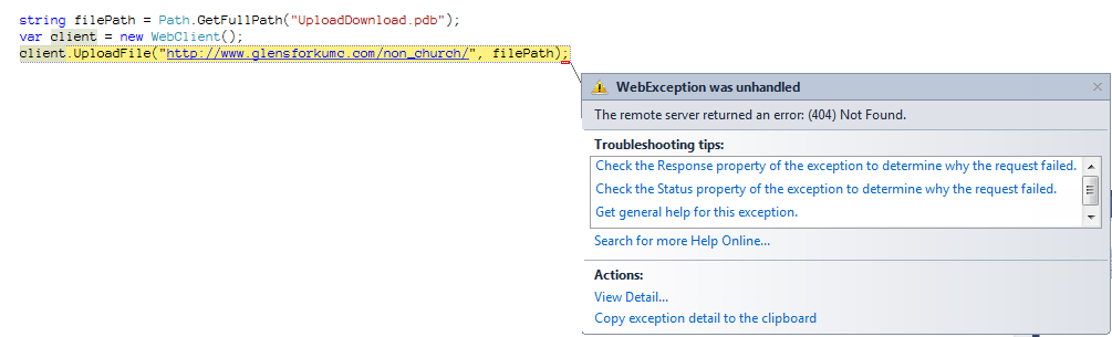

Hmm, it seems that I cannot get a file to upload to my website, using C#.  Here's my code (note: the only substitutions made here are that I've substituted "my_username" for my actual website username, and "my_password" for my actual password to the website):
I keep getting a 404: not found error.

Tried the code shown in the screenshot, with the resultant error (note: I'm trying to upload file "UploadDownload.pdb" that resides in the application directory of my C# app.  I want to upload it to the following directory:
http://www.glensforkumc.com/non_church/
I expected an error about not supplying a username and password (which should be required), but I'm getting the following:

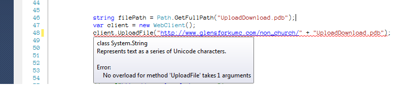

Hm... I don't usually work in C# (yes that's a disclaimer) But in the code samples I saw online polking around, I got the impression that the filename needs to be added to the target url so it knows where to put it. Something like this:
Client.UploadFile("http://www.glensforkumc.com/non_church/"+FileName)
Also if IIS is configured to allow anonymous access, you're never gonna get asked for a password. Thy breaking the project into seperate chunks. (Temporarily) Allow anonymous write access to the target directory, set the NTFS permissions to allow it also, and then try uploading the file.
Also make sure you pick a small file to start/test with because IIS has default size/time limits that tend to bite.

Hmm, yeah, I can see why some of the examples would lead you to think that a concatenation is called for; however, there's no overload of the method that takes a single argument:

Thanks, guys.  Following up on your links and doing some reading, I've discovered it seems inordinately involved to accomplish what I'm wanting to do with http.  I'll keep researching this.  I have the following domain, which I've had for the past 18 months:
It's a church website, but I pay for the space personally, and reserve the "non_church" subdirectory for my own use (hey, we've got 600 GB of storage, and after 18 months of use we've only used about 2 GB ;))
So, I have the required username and password to access the website.  I'm able to use FileZilla easily to upload files.  I realize that the difference is that FileZilla is using FTP, not HTTP.
What I'm looking for is simple code (no more than a few lines) to upload a local file to a specified subdirectory on the website.  I'll continue reading from the posts you linked to, and thanks!
