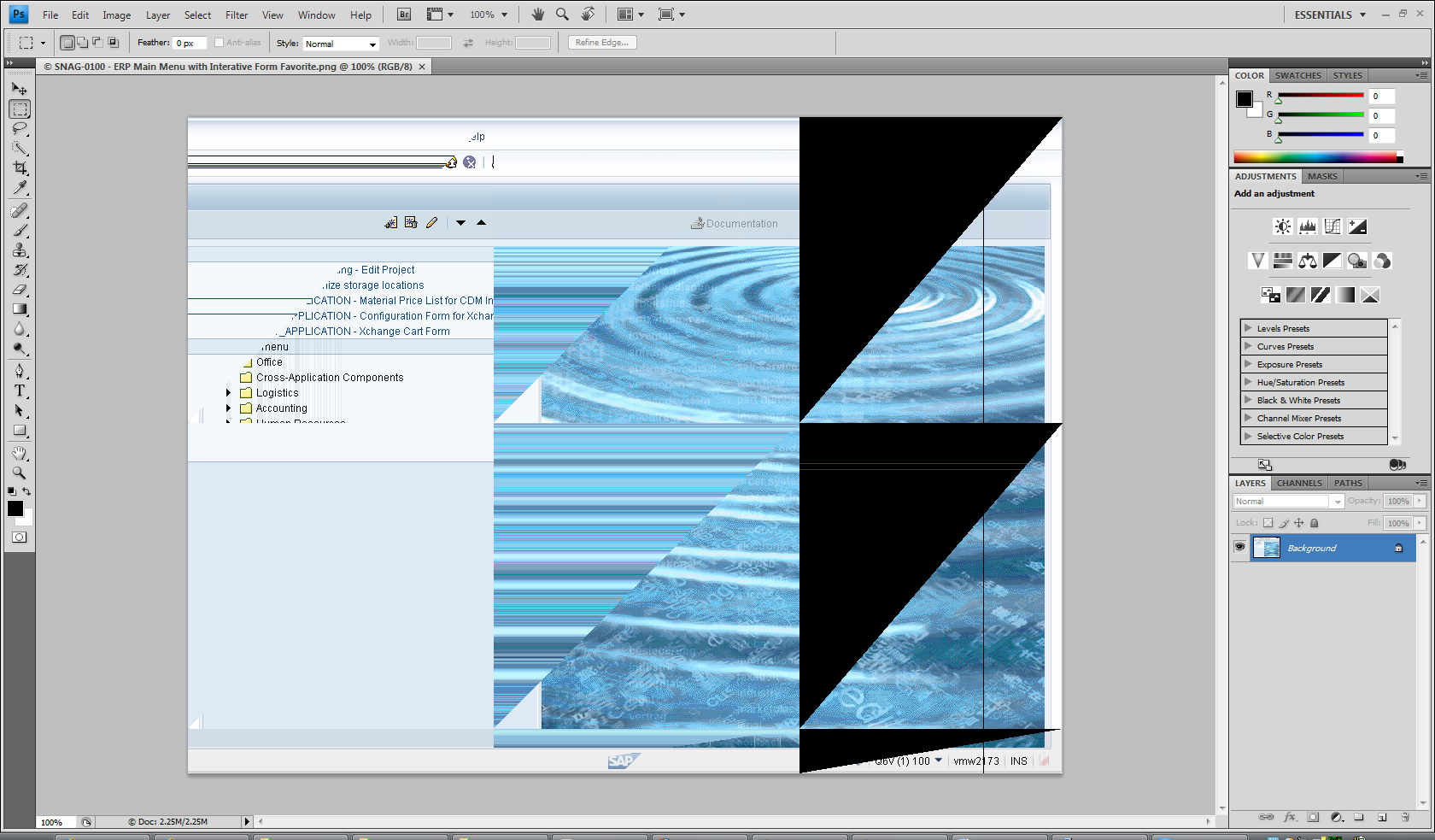

When I open any image in Photoshop, it is all screwed up like in the attached screenshot.
At 200% zoom, it looks alright but when viewing at anything less than 200%, the image doesn't appear the way it is.
Any idea?

yksyks: Sample file
lanux128: Yes, the problem persists after restart.

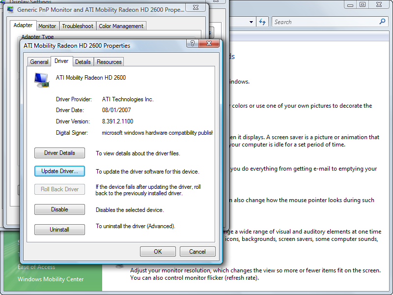

Here is system info copied from Photoshop's Help -> System info
I tried updating the graphic card driver and got the message that it's up-to-date.
GraphicCard.pngImages don't show up properly in Photoshop

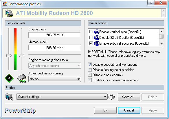

I have just installed and uninstalled ATITool. It takes a lot of time to come up after starting and is stuck with 'Not responding'. I had to kill it. I don't think it's vista compatible.
I am going to try PowerStrip mentioned here.

Kamel:
The two vertical slider bars on the left side of the window under "Clock controls" are used to set the clock rates for the video card. The left slider bar controls the GPU clock rate which this window calls the "engine clock". The right slider bar controls the video RAM clock rate which this window calls the "memory clock".
It is these two values that I should try reducing by 5 each, correct?
<a href="https://sridharkatakam.com">My blog</a>

« Reply #16 on: November 15, 2009, 02:54 PM »
Yes, that's correct. You can play it by ear... don't let it adjust the clock settings on reboot automatically until you've found settings that work well for you. It's my estimate that going down 5 on both sides will help eliminate any graphics card related issues you're having atm.
Let us know how it goes.
