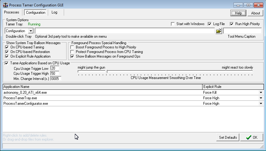

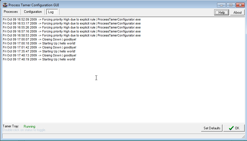

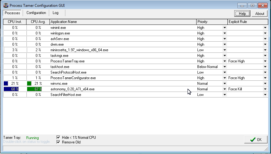

I am doing distributed computing, and use GPU's for heavy duty calculations. Sometimes there is a "display driver reset" causing the GPU application to reset (shown in system tray, normal exe). I have tried to use process tamer to force kill the app if it uses more than 50% of CPU time. I tried starting the app with administrator privileges, but it just won't kill it. Using Win7x64. Here's a few screenshots:

ok look's like you guys have found a bug -- working on it.. do you have a link to this astronomy application that i can test on?
what i may do barring that, is upload a demo version for you that will save more verbose log messages to help figure out what's going wrong.
