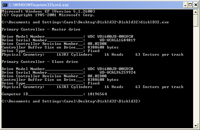

This seems to work for my drives: http://www.codeguru....on/article.php/c2815
It is a DOS command (open a DOS command prompt window in the folder with the .exe file and type DISKID32.EXE at the prompt).
It reports the drives on my system, except for the drives in a RAID array, but I have a RAID utility which can do that from Promise (the RAID hardware I am using).

Did you try DISKID32 ?? It does actually work. If you want to be able to email it to someone who doesn't know how to open a DOS window you could easily set up a batch file to do it for them. Something like:
DISKID32.EXE
PAUSE
would do the job.
Save the batch file into the same folder as DISKID32.EXE and then send the whole folder as a self extracting zip file which executes the batch command.
Would you like me to try and put this together for you?
Here is the output on my machine:
