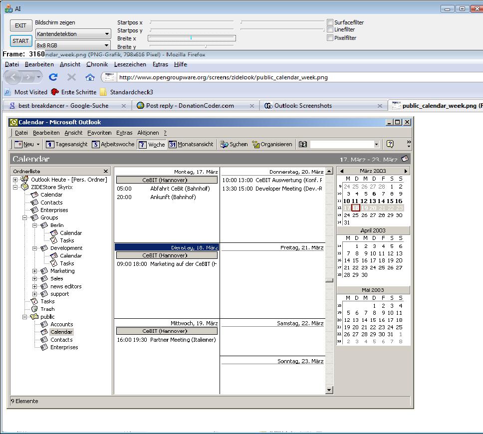

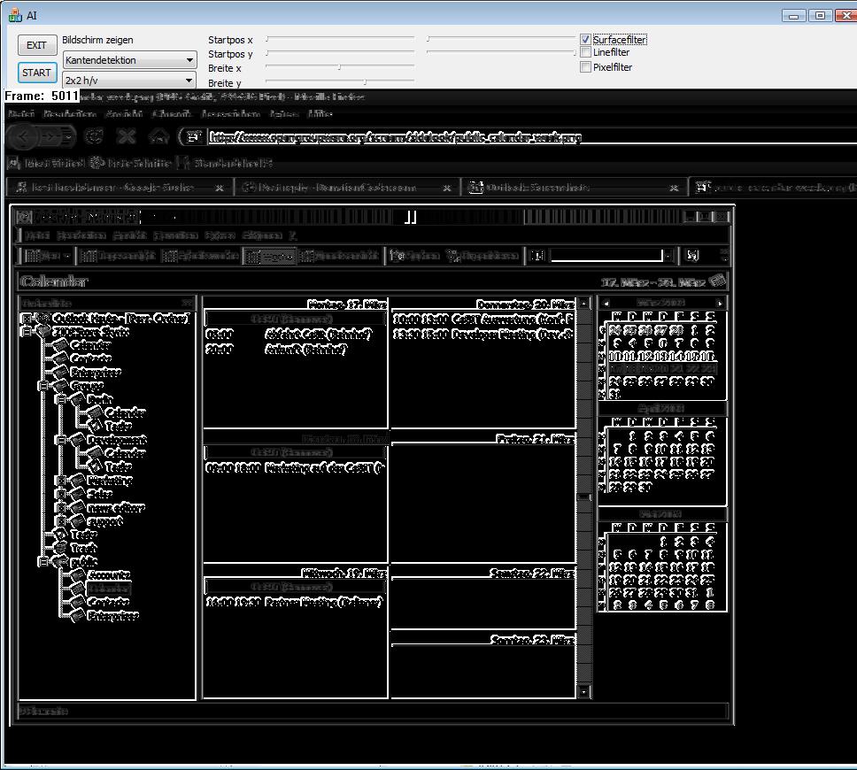

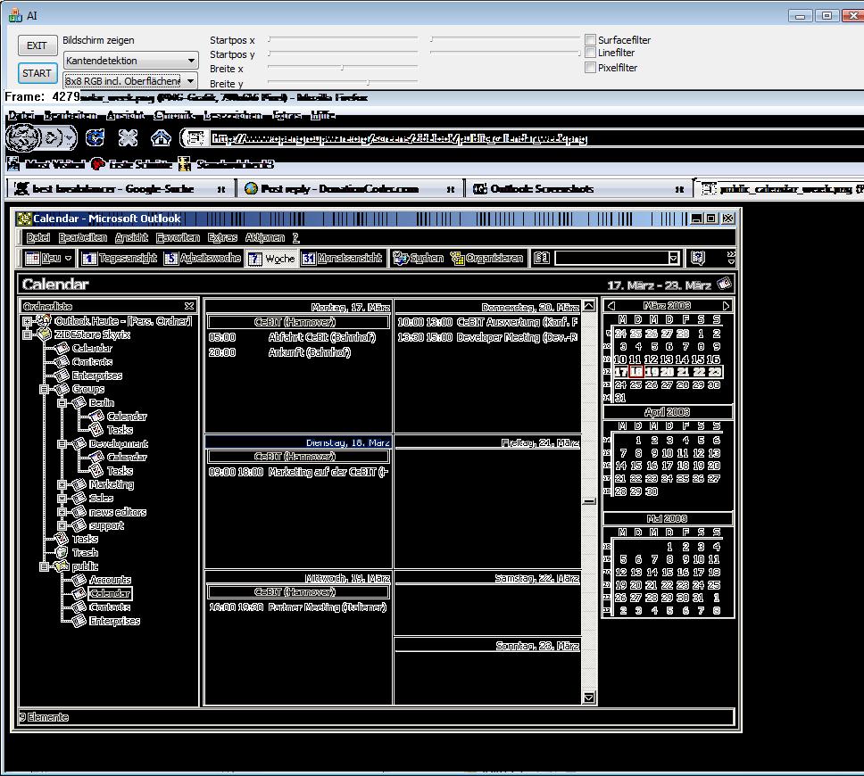

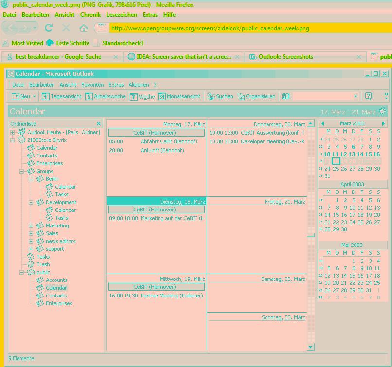

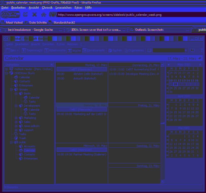

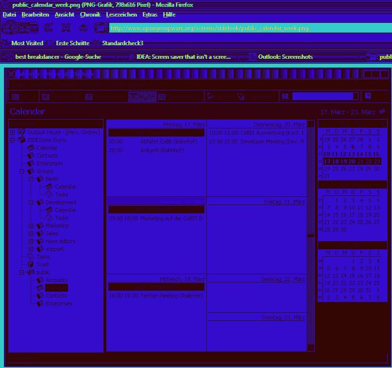

I made a surface-filter with edge-detection and the most surfaces in Outlook are totally the same. So you´d only see the important "differences". Fading between the normal screen, filtered screens and combinations of partial movements could do the job. Would this be an alternative? Some other examples with my creation I called "Screenflop" are the following screens.
Normal Window: Outlook normal.jpgIDEA:  Screen saver that isn't a screen saver...
Filtered Window1: Outlook surface filtered.jpgIDEA:  Screen saver that isn't a screen saver...
Filtered Window2: Outlook hv filtered.jpgIDEA:  Screen saver that isn't a screen saver...
Screenflop1: Outlook Screenflop1.jpgIDEA:  Screen saver that isn't a screen saver...
Screenflop2: Outlook Screenflop3.jpgIDEA:  Screen saver that isn't a screen saver...
Screenflop3: Outlook Screenflop4.jpgIDEA:  Screen saver that isn't a screen saver...
« Last Edit: December 02, 2008, 06:19 PM by Crush »

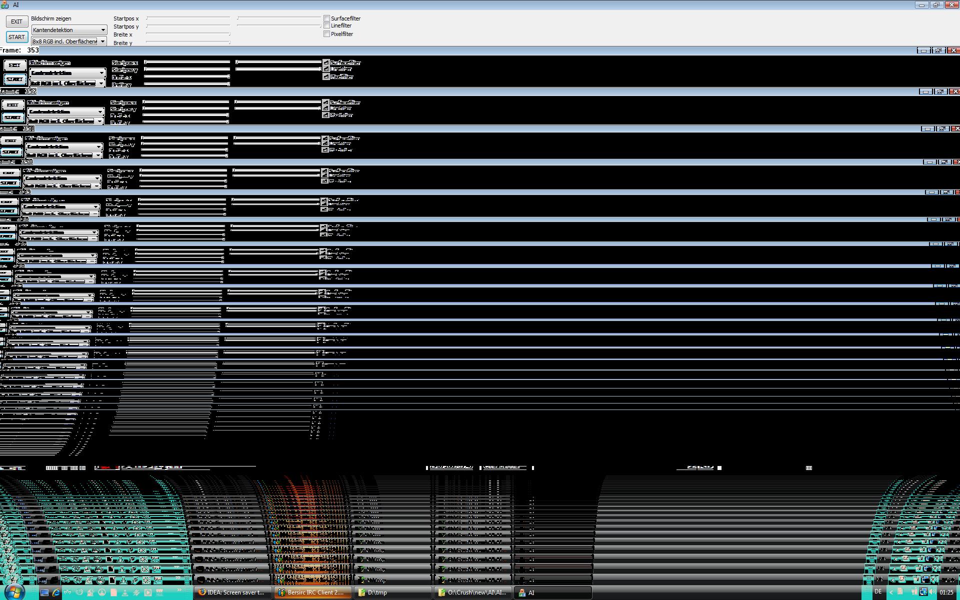

« Reply #8 on: December 02, 2008, 06:20 PM »
The whole screen will be changed. On the top you see my program that converts the screen and shows the result in an own window. It can on the fly zoom and move parts of the screen, perhaps this could be also useful? It´s not very complicate to copy the result back to the original screen and hide the program in the background. But you also wanted fading and so on, this means I would have to change the code a little bit. I must check out how to work with changes direct on the screen. At these screenshots the original picture was on another second monitor. If you make a direct screengrap again and again you get a recursion that looks later on like this:
Direct Screengrap recursive.jpgIDEA:  Screen saver that isn't a screen saver...
« Last Edit: December 02, 2008, 06:27 PM by Crush »
