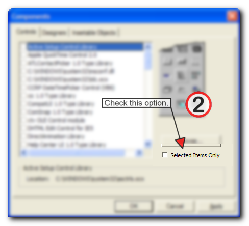

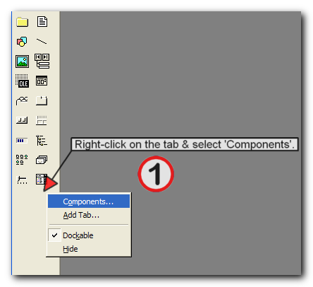

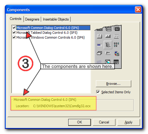

this is a topic in view of the ongoing NANY 2009. anyone programming in Visual Basic need to include all DLL/OCX files manualy if they're not using the PDW (package deployment wizard), so i prepared a simple guide to ensure that all the necessary files are distributed together.
Fig. 1
Fig. 2
Fig. 3
