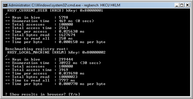

Looks like DC friend Jeremy Collake (maker of PECompact) released a cool little utility recently that benchmarks registry speed.
As Martin on ghacks points out, this will finally make it much easier to answer the questions about the effects of registry defragging and cleaning.  I can't wait to see the benchmark scores on before and after registry defragging so we can see what the real speedup is.
from http://www.ghacks.ne.../registry-benchmark/
