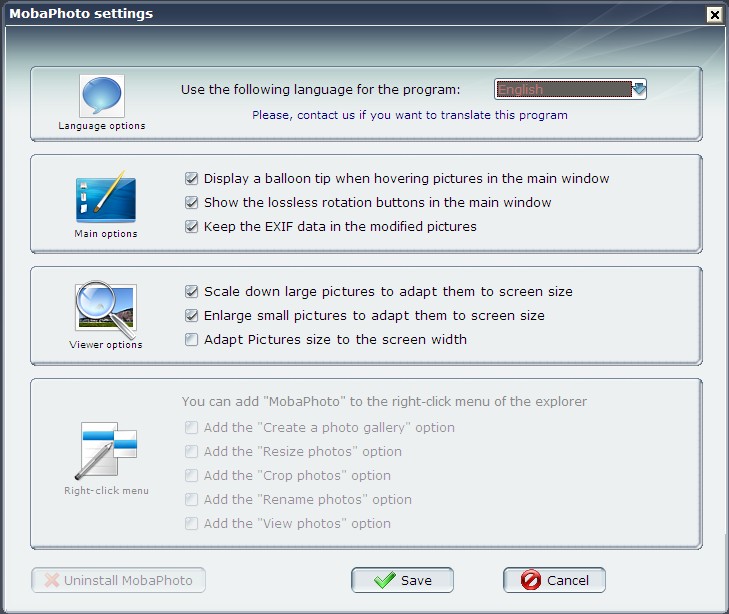

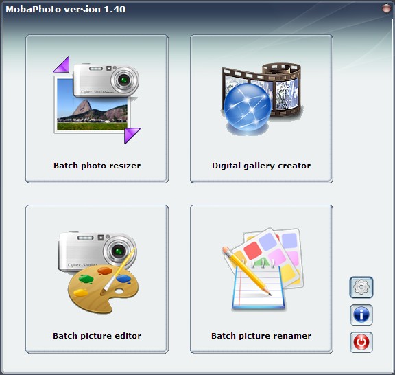

Mobaphoto is another tool that supports batch processing (freeware and portable)
