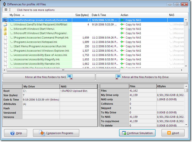

I currently use SyncbackSE, but when I am travelling with my laptop I only need to backup a few files/folders a day, to USB-stick or via FTP.  But how to keep track of which files?
Since you are using SyncbackSE, you do not need any other software. It is already embedded there. Before actually implementing the backup, you get by default a confirmation window called "Differences for profile" with the list of files that will be added to the destination / modified in the destination / deleted from source. All the information that you want to know is there.
In anycase, it is better to user only one software, as you may not get exactly the same results if you use different softwares and you may be mistaken.
Here is a screenshot as an example:

ppass, I know about the "differences" screen in SyncbackSE (useful screenshot though, for anyone else reading).  The problem is that each time I use SyncbackSE, once my destination drive is plugged in, the whole process of scanning, comparing and writing can take up to 15 min, for my three main backups, since syncbackSE scans everything all over again. It's the scanning that takes a long time.  I have some large folders of too many small files (worth discussing in another post sometime - let's just say scrapbook extension for firefox), my thunderbird mail folder is very big, and other odd files are distributed in various places within large directories.  I've tried a system of keeping "new stuff" in one place to help the backup along but I find I can't organise my work with temporary folders and remembering to "file away" later etc.  So I am stuck with the filing system I've got, which works for me, except when it comes to regular backups.  There are various reasons why I don't keep the thumb drives plugged in all the time; security, the fact that they sometimes don't play with with hibernation, the fact that I only have three usb ports which are mostly in use (mouse, phone and second "foreign" phone) and I've not yet managed to find a hub that works consistently (perhaps I have a hardware problem there?).

You are right, when the USB drive is not plugged-in, then SyncBackSE refuses to go to the "differences for profile" window and flashed a pop-up window "Failed to prepare destination". This is normal, because in essence, it scans the destination to make the list of files that have not been backed up yet.
Be aware that the time-consuming part of SyncBack (and any other backup utility for that purpose) is the time to write to destination. The scanning of the source and build-up of the "differences for profile" is usually quick (at least, this is my experience with a disk with 5GBs of data).
