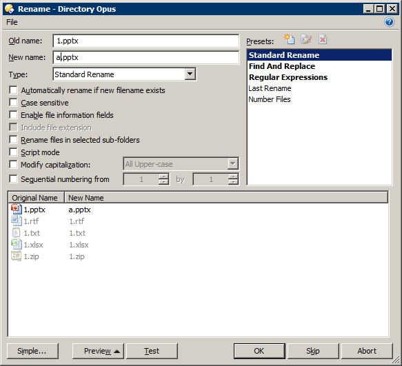

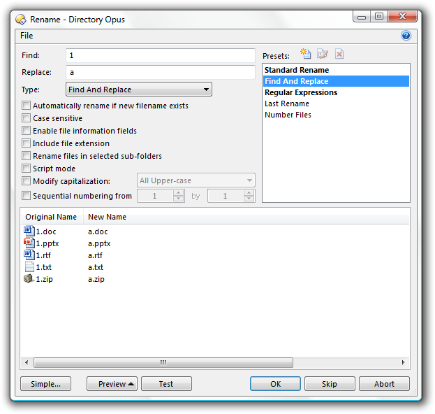

Sorry, maybe I wasn't clear enough: how can I rename those files simultaneously to a new name? Or you can call it batch rename. I just want that all files in that pic to be called a.pptx, a.rtf, a.txt and so on.
The simplest way in your situation:
« Last Edit: October 02, 2007, 07:02 AM by Dirhael »
