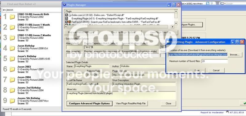

I think I'm doing something wrong here. I put the dll in the newly created folder and put es.exe into Everything's folder. Then I pointed the plugin to where es.exe is. When I type "ev" into FARR, all I get is a list of all the folders on my computer. If I try "ev something", I get explorer opening to a folder with "something" in its name.
Vrokolos
  • Posts: 11
    • vrokolos
Re: Everything plugin for FARR
« Reply #6 on: January 15, 2009, 05:11 PM »
Try *.exe, some*.exe, *.mp3, *.avi, something\*.mp3, s*thing.doc etc :)

« Reply #7 on: January 15, 2009, 06:28 PM »
Yeah, still not getting it. When I type "ev", FARR is not seeing that as pointing to Everything. Everything is running.
http://i23.photobucket.com/albums/b387/edbro9/farr3.jpg

« Reply #8 on: January 15, 2009, 06:30 PM »
But those 9 results in the screenshot are from everything..
Everything just searches your hard disks for files and folders using really fast indexing
Nothing more.. It's a faster locate32
edbro
  • Posts: 426
« Reply #9 on: January 15, 2009, 06:32 PM »
Oh, now I see. I was expecting it to open up Everything's result window. Very nice indeed!  :-*

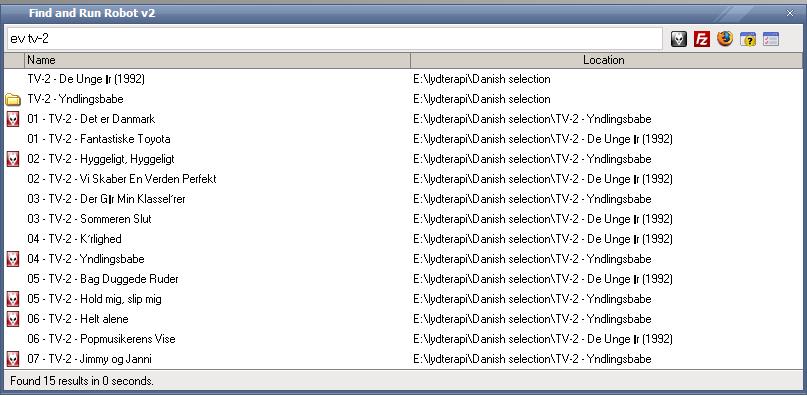

But having danish as my native tongue causes a problem for FarrEverything (and for Locate32 as well) - it can't locate files with danish letters in the filenames - then it looks like this:
When I try to execute a file with the faulty letters ("æ", "ø" and "å"), nothing happens, because the path is wrong. I hope it can be fixed somehow.
/Jesper.

Hey Vrokolos.
Still enjoying the fruits of your work with this plugin, thanks a lot. Is there any chance that you might fix the character problem? Is there anything I can do myself to fix it, like altering options?
Thanks.
Jesper.
